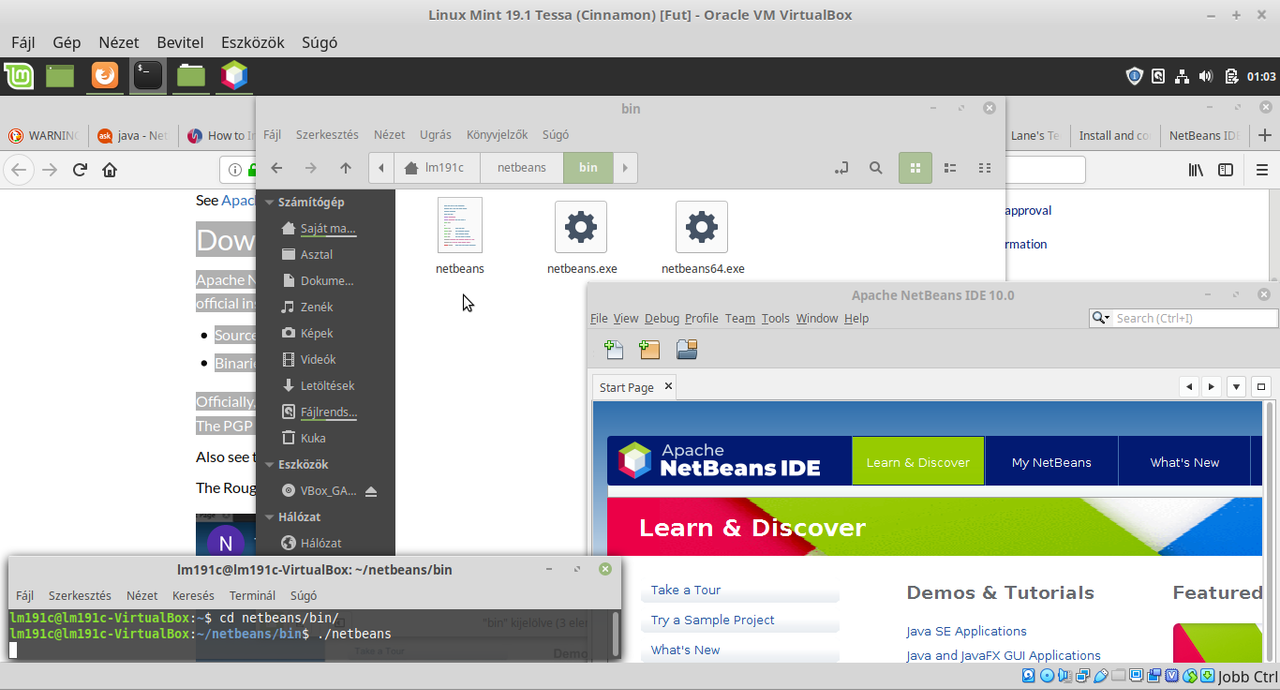

#2 Van egy újabb
Letöltöd
Apache NetBeans 10.0 is available for download from your closest Apache mirror. For this release no official installers are provided, please just download the binaries and unzip them.
Officially, it is important that you verify the integrity of the downloaded files using the PGP signatures (.asc file) or a hash (.sha512 files). The PGP keys used to sign this release are available here.
In short, Apache NetBeans (incubating) 10.0 is a full IDE for Java SE, PHP and JavaScript
development with some Groovy language support.
Read more on our download page:
https://netbeans.apache.org/download/nb100/nb100.html
New & Noteworthy features of the 10.0 Release: http://mail-archives.us.apache.org/mod_mbox/www-announce/201812.mbox/%3c...
(https://www.apache.org/index.html#projects-list)
Kibontod (saját könyvtár) ...
Indítod
cd netbeans/bin/
./netbeans
Így néz ki:
Videó: https://www.youtube.com/watch?v=O8cwpEY1OAQ
A letölthető bináris hordozható alkalmazás, más ismert neve: portable. De könyvtár alakban van, és nem egyetlen futtatható fájlként.
